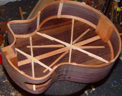

Here's a shot of the guitar I'm building, using the same locations as Kenny Hill does on his classicals:
I think they're one inch diameter (body is only three inches deep at the heel). I have no idea how it will sound, as this is my first guitar. By the way, those holes are for the adjustable bolt-on neck, using Harry Fleishman's system.

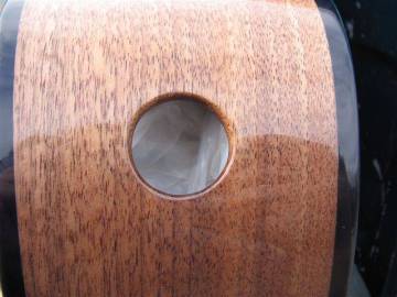

PostPosted: Fri Apr 08, 2005 10:05 am
Posts: 458
Location: Southern Ohio
Okay Dave, I finally got a pic of my port. It's a 1 inch diameter hole. This is my first and I strung it up before finishing. I really like the sound with the port; it seems to have a fuller sound. BTW, from looking at some of these pics, I think some of these other guys used the copy of my port template. ;-)

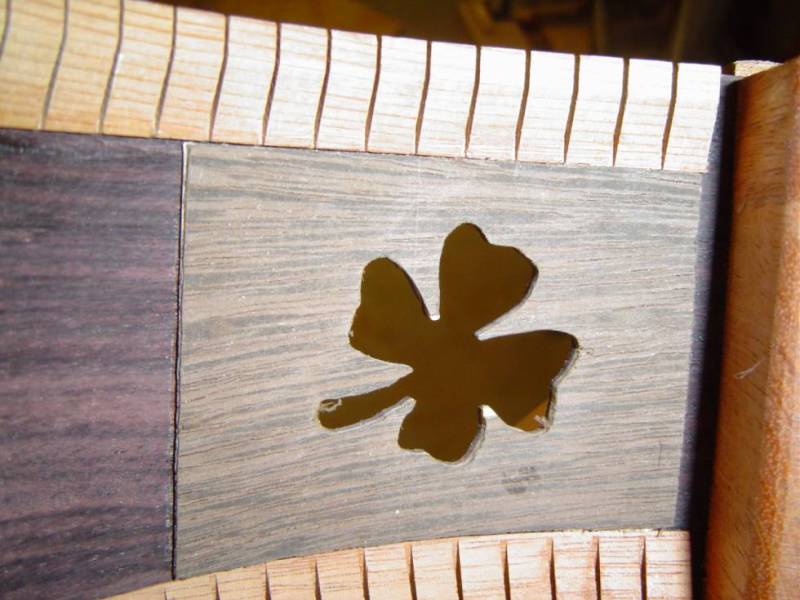

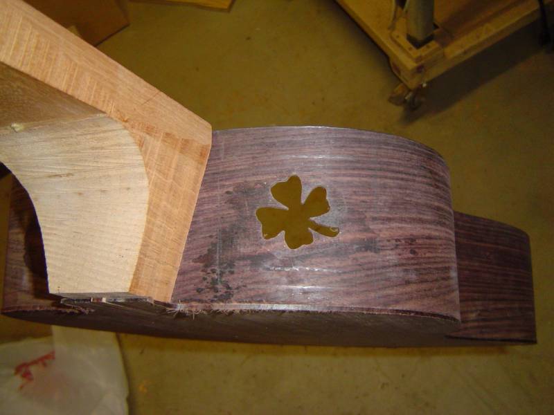

PostPosted: Fri Apr 08, 2005 12:31 pm
Posts: 2356
Okay, I figured out how to resize the photos. Here is a soundport I use in some of my classical guitars.
PostPosted: Fri Apr 08, 2005 1:23 pm
Robbie--
Do you find that the shamrock gives you better tone than the skull and cross bones?
Or a three leaf clover for that matter?
PostPosted: Fri Apr 08, 2005 1:27 pm
Posts: 2356
hahaha, good one Steve! I was just trying to show the Irish roots. I have noticed that the guitar projects much more with the soundport than without it. There is more volume for the audience with the port.
PostPosted: Fri Apr 08, 2005 2:00 pm
I've heard--and read--this same thought so many times I'm beginning to believe it.
Do you have a theory why the port works so well?
What do you suppose is going on?
(You got some 'splainin to do)

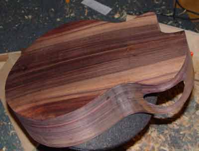

PostPosted: Fri Apr 08, 2005 4:10 pm
Posts: 251
Not the greatest pics, but here's my contribution to the soundport revolution! :)
